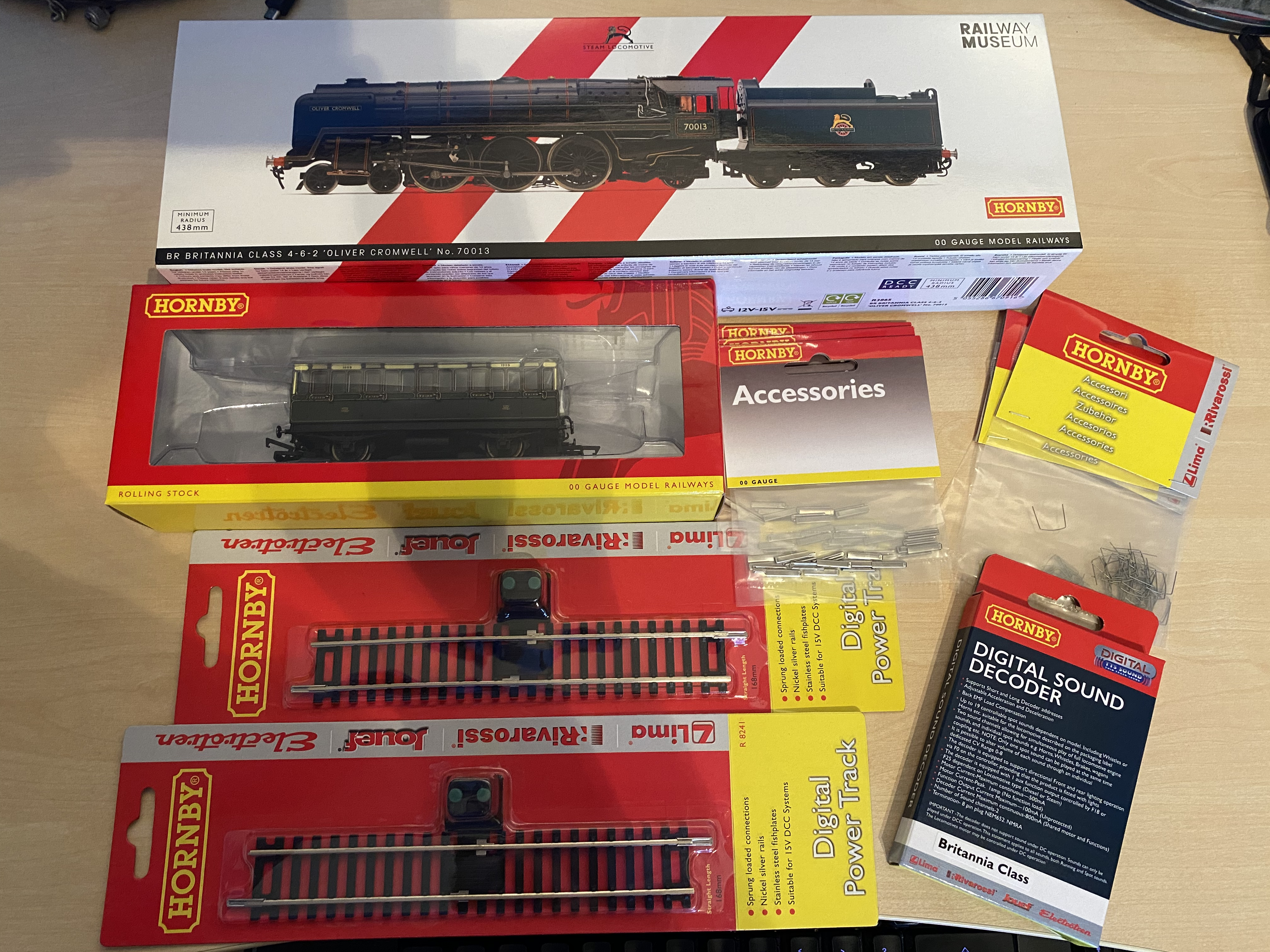

Another delivery, another train. That’s three now and I don’t even have a layout! The Britannia class loco is absolutely stunning and I’m glad I chose it as my main loco. I got the sound decoder because I want to try one at least once and see if I like it or not.
I can only work on my loft for a few hours a week, so it’s not progressing as fast as I would like, and I can’t fully commit to a layout until I know just how much room I have up there.
Still, buying everything so it’s ready to go as soon as the loft is finished will be a bit like Christmas. All I’m really waiting for now is the elite controller and the terrier train pack.
Are certain brands of lubricating oils better than others, or are they all the same? The Gaugemaster and Expo brands seem to be popular.
RDS - I apologise if you need to rotate my picture again. (Moderator Note: Done - No problem!)
