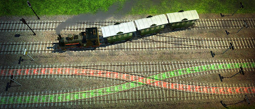

Am I right in thinking that he makes these track pieces by splicing together multiple points and track pieces? If so, you could theoretically design any piece you could think of?
Some of those pieces are amazing, I would have never thought of most of them. Thanks for the suggestion Corky.
One piece I am surprised Hornby don’t make is the diamond cross over piece, but I see that Peco make it. Something like this would save a lot of space.
