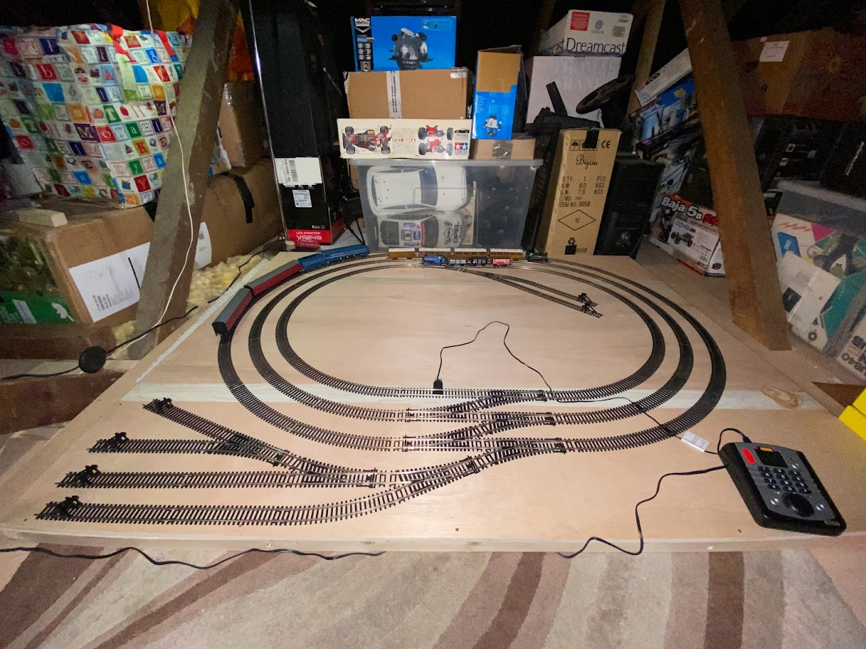

Hello everyone, hope you're all doing well. I've been rather absent lately, I haven't been able to make any progress on the loft, and not much new on train front. I'm expecting to have it finished by the end of this summer.
Even so, I managed to get a weekend off and knocked up a quick track base made out of some scraps I had for the loft. I have a full cork underlay ready to go, took me three hours to cut out all the shapes, but it was enjoyable. Even though I will admit, the trains going round on just the wooden surface didn't make as much noise as I expected.
It's not much, but it's a start! Here is my incredibly modest first layout. I have some adjustable furniture legs on the way to raise it up off the floor.
Forgive the mess, the loft is still a work in progress.
Things I've learned from just having this very basic layout:
Don't forget the DCC clips.
A programming track is so so very handy. (I don't have one)
Placing a train on the track with the wheels aligned on the track is obviously a skill honed over time.
When your points are all manual, keep an eye on them!
Trying to uncouple a coupling can be very fiddly.
I've had no running issues so far, other than both my Large Praires will not function on the points. They approach, stop, judder, then keep going, sometimes. None of my other trains have any issue with points. So I'm assuming it's something to do with this particular Hornby model.
