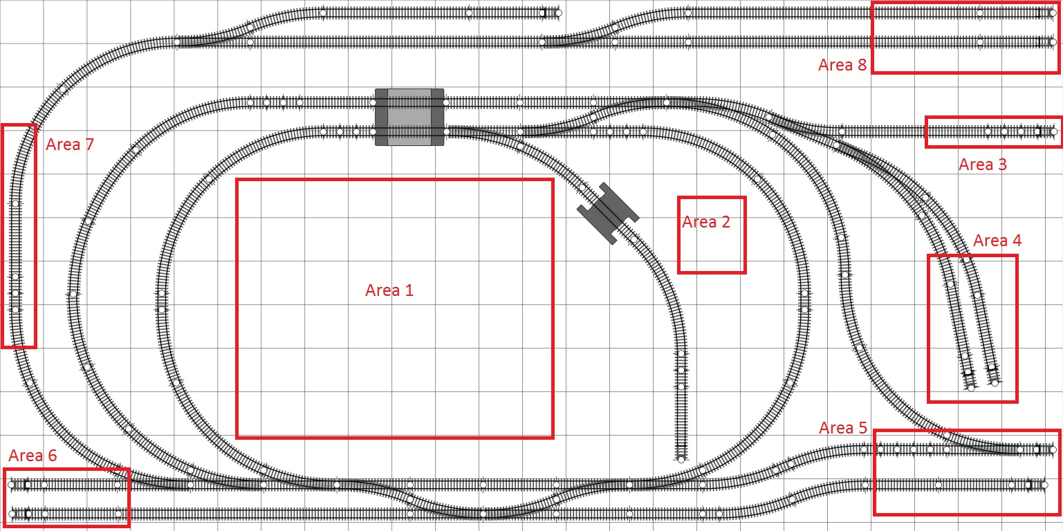

Posted at 16:27:39 Fri 8 Oct 2021
Thanks Al, that makes choosing wagons and engines easier.
I’ve been using the AnyRail software and I’m wondering how accurate it is. I spend a lot of time making sure all the joints match up and are “proper”. But sometimes there is a tiny gap, or the alignment is off very slightly.
When transferred to actual track, is there any give or play that can overcome these small gaps, or is what I see on AnyRail what I will see with actual track pieces?

Posted at 16:51:49 Fri 8 Oct 2021
I’m not conversant with Anyrail but in SCARM you can adjust the tolerances for “fit” and that applies to the real world. There is some wriggle room ……. to an extent. Are there any adjustable settings in Anyrail? R-

Posted at 18:31:26 Fri 8 Oct 2021
This is a rough idea of what I'm looking to make. It feels a little tight, so I might try and slim it down a little.
I welcome any and all criticisms of my layout. I've only been using AnyRail for a few hours, so I still have a lot to learn. All connections seem to be correct, and I didn't need to adjust the tolerances in the end.
The areas are:
  1. Town or village area.
  2. Church or some other kind of important building, like a pub.
  3. This track will eventually lead to a tunnel for a future expansion, but until that happens, I'll use this section as a utility or loco shed.
  4. Shed for locos.
  5. Again this track is aimed at future expansions, but it doesn't do much for the current layout, so I may change the track to point left, and create another oval.
  6. Same deal as area 5, aimed at future expansion, but good for shunting and wagon storage until then.
  7. Now this bit is very ambitious. My plan is to have this become a slope upwards, which continues round all the way to section 8. The plan is to use the roof beam in my loft as a single track bridge so that I have a way of reaching the other side of my loft, and another 8x4 workspace. I can see how this will work out in my head, but.. it's messy in there.
  8. This is where the gradual slope will reach the roof beam. This is probably the last thing I will try to complete.
There will be a road running out of the top of the town over the double crossing which makes an instant right turn, then continues along towards area 3/8 and into another tunnel.
Having the ability to build a virtual track layout like this is amazing. The idea of trying to do this on the board with real pieces does seem fun, but also quite expensive and probably frustrating.
