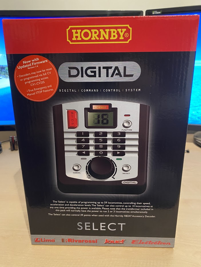

I purchased the Select maybe an hour ago, Hattons had one left and I thought I’d better snap it up before that too disappears.

I purchased a 3metre lead but knew it wouldn't be long enough, so I used the very handy cancel order feature on Amazon, (that I didn't know about), and got a 5metre one. That will be more than enough for any location in my loft. Many thanks for the links Chris.
I doubt I'll have any time to set things up and use this tonight, so this will likely have to wait until the weekend. But it's here, and I can finally get those locos moving! I'm excited, but also a bit nervous that I'll get a dud.
I'll have a thorough read of the instructions, then I'm just going to use a 2nd radius oval with the R600 and R8241, as I'm still missing various pieces of track I need.
Is 1.6 the latest firmware available?
Edit: I managed to set up a small section of track on my desk, it's just R607 - R600 - R8241 - R607 with my R3721 going back and fourth at low speeds. I saw a video by Sam that this loco was quite poor, and his had a rather shoddy crawl, but mine has an amazing crawl. Obviously I can't tell much from four pieces of track on my desk, but at least I tried it, and it works.
