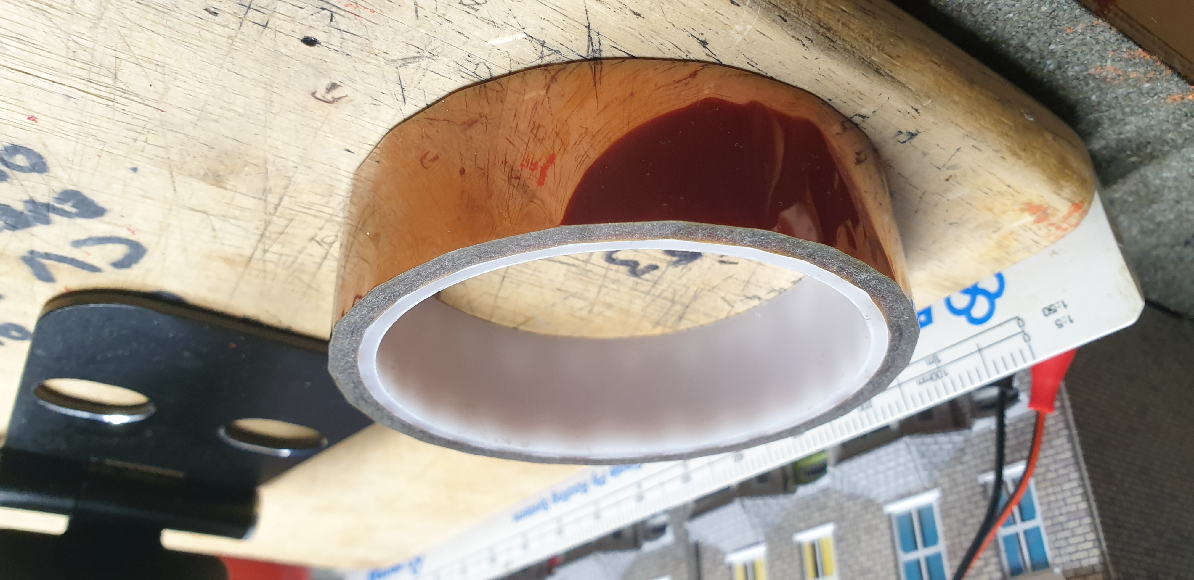

I saw a video where someone had wrapped their decoder in an orange/yellowish transparent tape material, but I can’t seem to find what it was. It almost looked like a sweet wrapper. Anyone have any idea what this could be?
Edit: After some more digging, the tape I saw in the video is Kapton tape. Have ordered a roll and will use that instead of electrical tape.

I also had the same thought about the electrical tape going sticky from the heat.

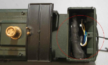

Thirty-eight locomotives currently in use at one time or another.
All wrapped in this...
