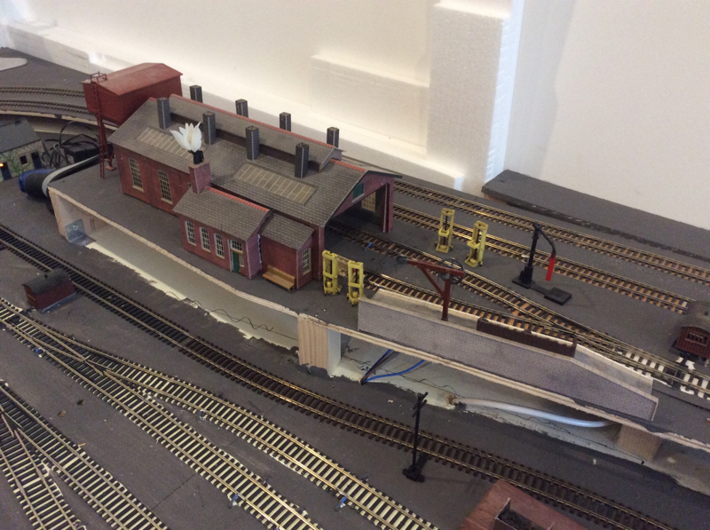

Posted at 16:07:10 Thu 3 Feb 2022
Still having a blast using AnyRail, using as many combinations of track pieces as I can, not because I plan to use them necessarily, but it’s a great deal of fun to make layouts, especially now that I’ve discovered how to add elevation and layers.
However, one track piece in particular that I’m struggling to find any use for is the R8076 Y point. Other than running down both sides of a station platform, it always feels like there is a better piece to use.
Does anyone have one of these in their layout that’s not used for a station that could shed some light on a good use for this piece?
Posted 16:07:10 Thu 3 Feb 2022
Posted at 16:15:08 Thu 3 Feb 2022
I use the Y-Point in combo with 2 x R628 and standard R601 straights to form parallel roads into a Metcalfe double engine shed. Spot on spacing for the doorway.
Posted 16:15:08 Thu 3 Feb 2022
Posted at 13:28:35 Fri 4 Feb 2022
I'm doing something similar, though slightly different from Rob. I have a left hand point going off to the first road in the engine shed. Then immediately after the straight leg of the point is another left hand point providing the second road into the shed. The straight leg of that point will lead on to passenger sidings. All sounds well - except, I cannot fit the second point in without the straight leg out to the sidings hitting the corner of the shed, and I cannot move the shed further back as it is at the end of the layout.
Sooo, I figure if I swap the second point for a 'Y' it should just nicely miss the corner of the shed. At least that is what I hope. I've had two large radius 'Y's on order for 2 or 3 weeks and they continue to be out of stock, as they seem to be with most other suppliers. I've managed to find one in Derails so I should be able to continue in a couple of days.
In general I think 'Y' points can be very useful when you want two roads of equal length, or when you wish to miss the corners of buildings joy.

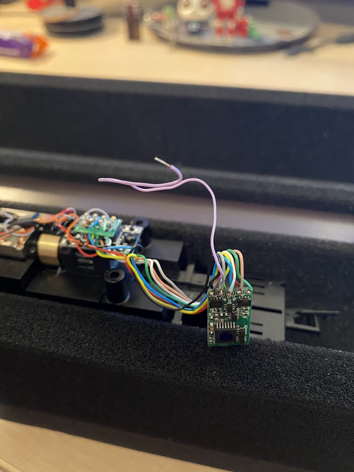

Posted at 20:44:37 Sat 5 Feb 2022
I'm assuming this isn't right?
Decided I'd get a head start and fit my decoders to my locos before my Elite arrives. Got two down without any issue, then as I was fitting this to my Large Prairie, I noticed this wire sticking out. It's not supposed to be like this, right?
Posted 20:44:37 Sat 5 Feb 2022
Posted at 23:18:33 Sat 5 Feb 2022
The "free" unterminated mauve / purple wire is perfectly normal. The decoder has nine wires but the plug only has eight pins, thus one wire has to be free. It is however, expected to be insulated if not being used to prevent shorts.
Posted 23:18:33 Sat 5 Feb 2022
Posted at 23:24:39 Sat 5 Feb 2022
Thanks Chris, the more I looked at it and inspected it closely, I followed all the wires and found they all terminated at a corresponding pin.
Just struck me as odd that this wire would be floating free and as you point out, uninsulated.
Would putting a small length of heat shrink tubing over this to prevent shorts be acceptable?
Posted 23:24:39 Sat 5 Feb 2022
Posted at 23:29:20 Sat 5 Feb 2022
Absolutely.....if shrunk down to make the insulation robust.
White wire is the first function and the yellow wire is the second function [both controlled by F0 directional lighting].
The green wire is the third function and the mauve / purple wire is the fourth function. The Fn controller numbers for the third and fourth function [where provided] will be stated on the relevant decoder data sheet.
For example the green wire third function on TTS decoders is typically F25. TTS does not have a free mauve / purple wire fourth function.
On a R8249, the green third function is F1 and the fourth mauve / purple function is F2. F1 can be used on the R8249 for a physical function because the R8249 is not a sound decoder, thus F1 is not reserved for sound on/off.
So it can be seen that assigned Fn numbers are a variable that is decoder specific.
Posted 23:29:20 Sat 5 Feb 2022
Posted at 10:52:39 Sun 6 Feb 2022
I have a TTS for my Britannia Oliver Cromwell and that was what I fitted first, and as you point out, that doesn’t have a free 9th wire, which is why I was a bit confused when I got to the R8249.
That’s a mountain of knowledge there Chris, I’ve got 10 more decoders to fit and I’m sure your help will serve me well.
Posted 10:52:39 Sun 6 Feb 2022
