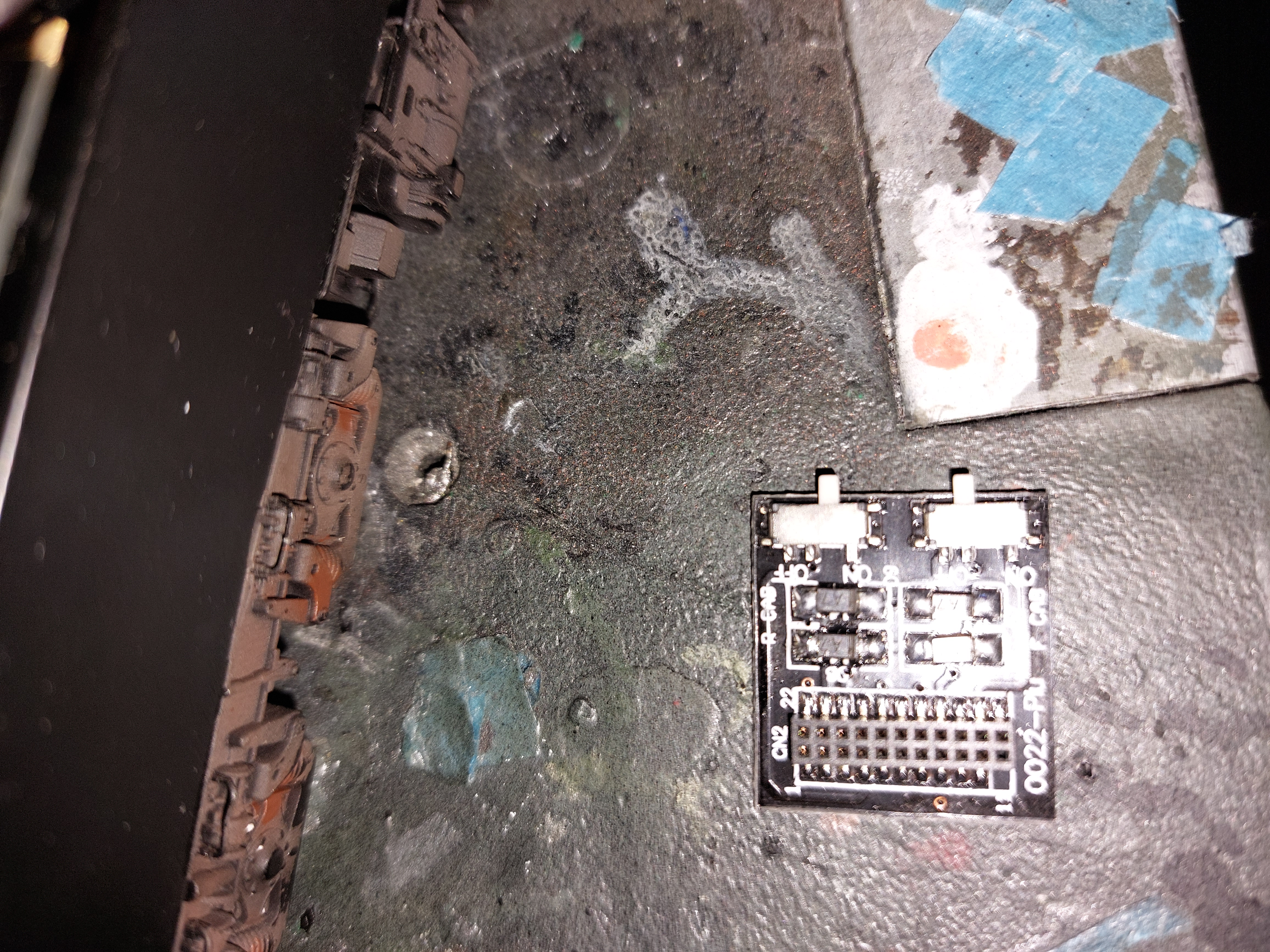

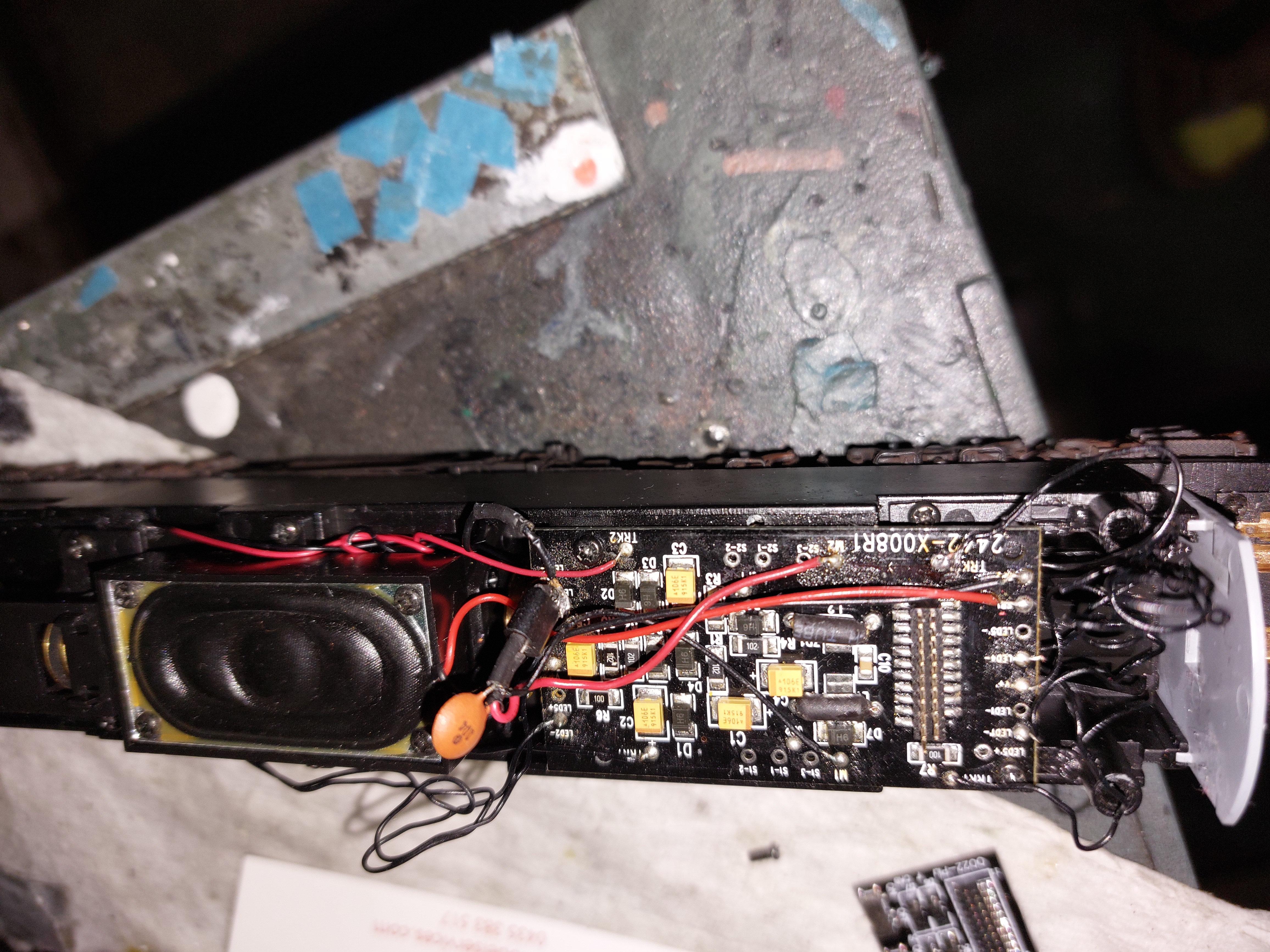

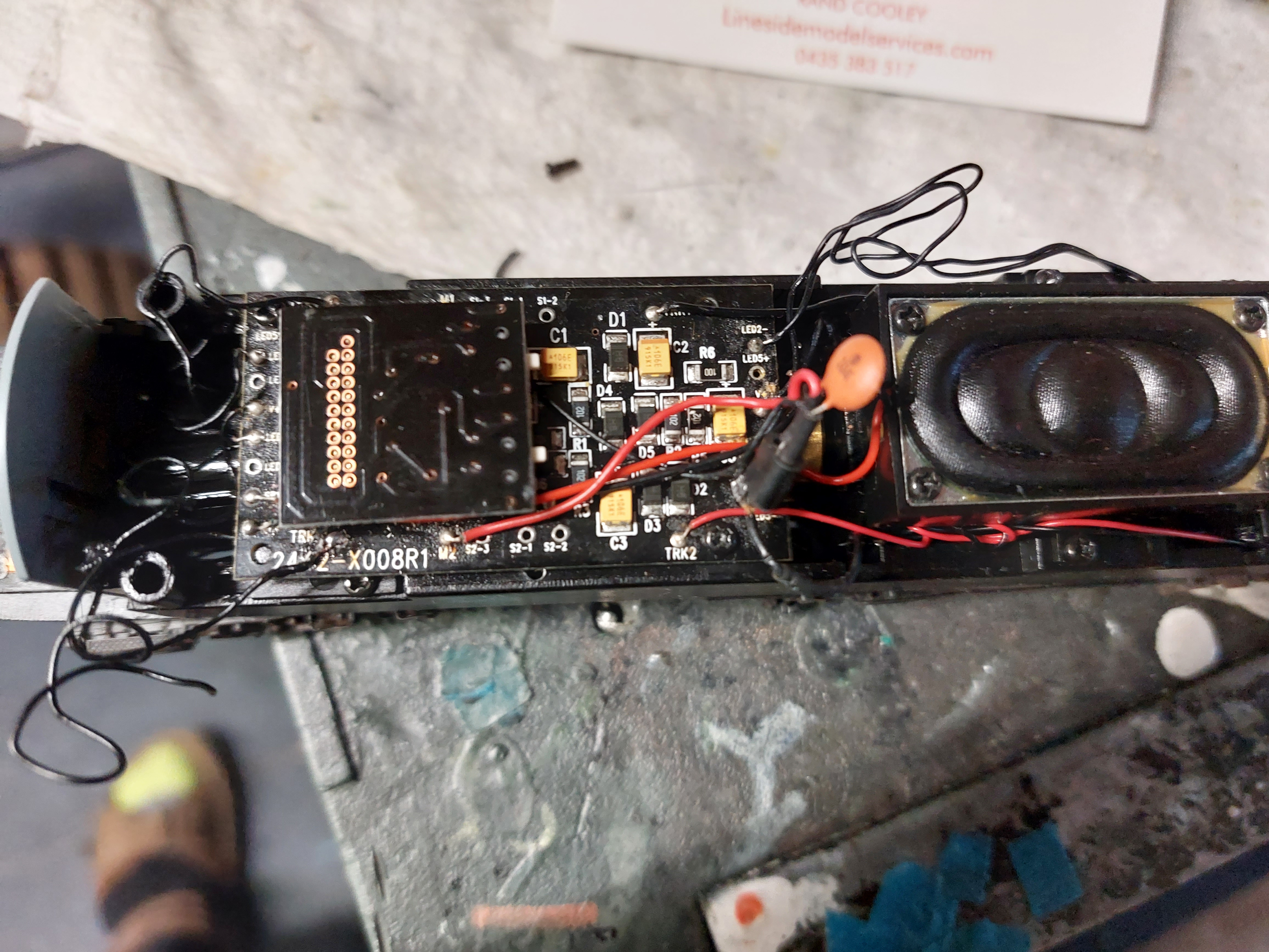

Here's a few photos of the PCB - upper part of the chassis.
Printed underneath the chassis it states 'DCC fitted' - so chassis NOT from R3050A.
As you see, the speaker is hard-wired onto the PCB. PCB is 21-pin.
You can see the blanking plug - with the 2 switches.
I tried all options - no lights.
All cables appear to be connected.
I tried 2 other blanking plugs - loco worked perfectly with them as well, but no lights.
Thoughts?

Stickswipe - always helpful - has replied to confirm Hornby did use 21-pin DCC decoders for their XS (digital / sound) models and it does look like one of them.
Lighting remains a puzzle - I'd like it to work as my other 2 do without (major) issue.
At least it's running very well, and the fans work again!
