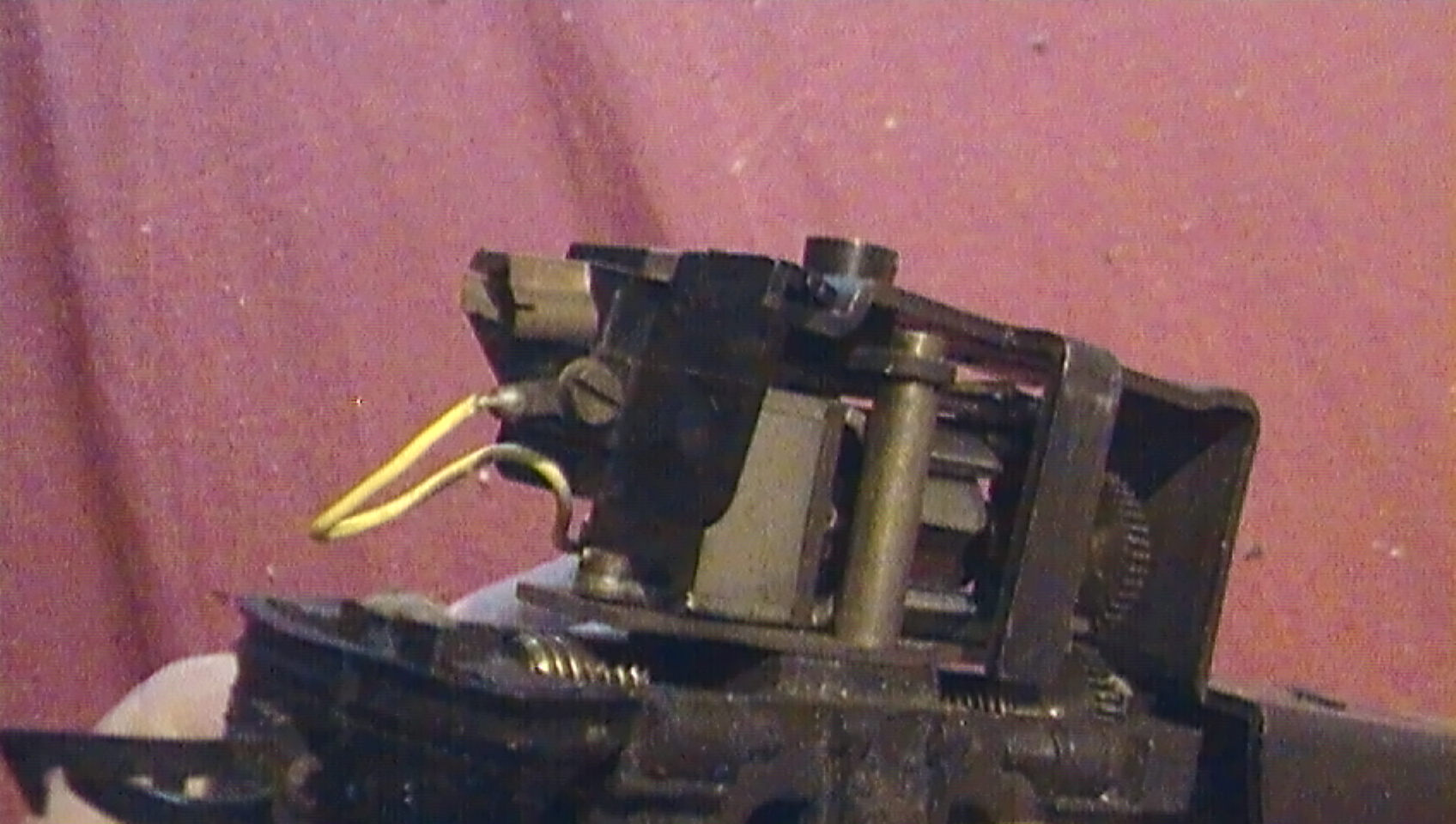

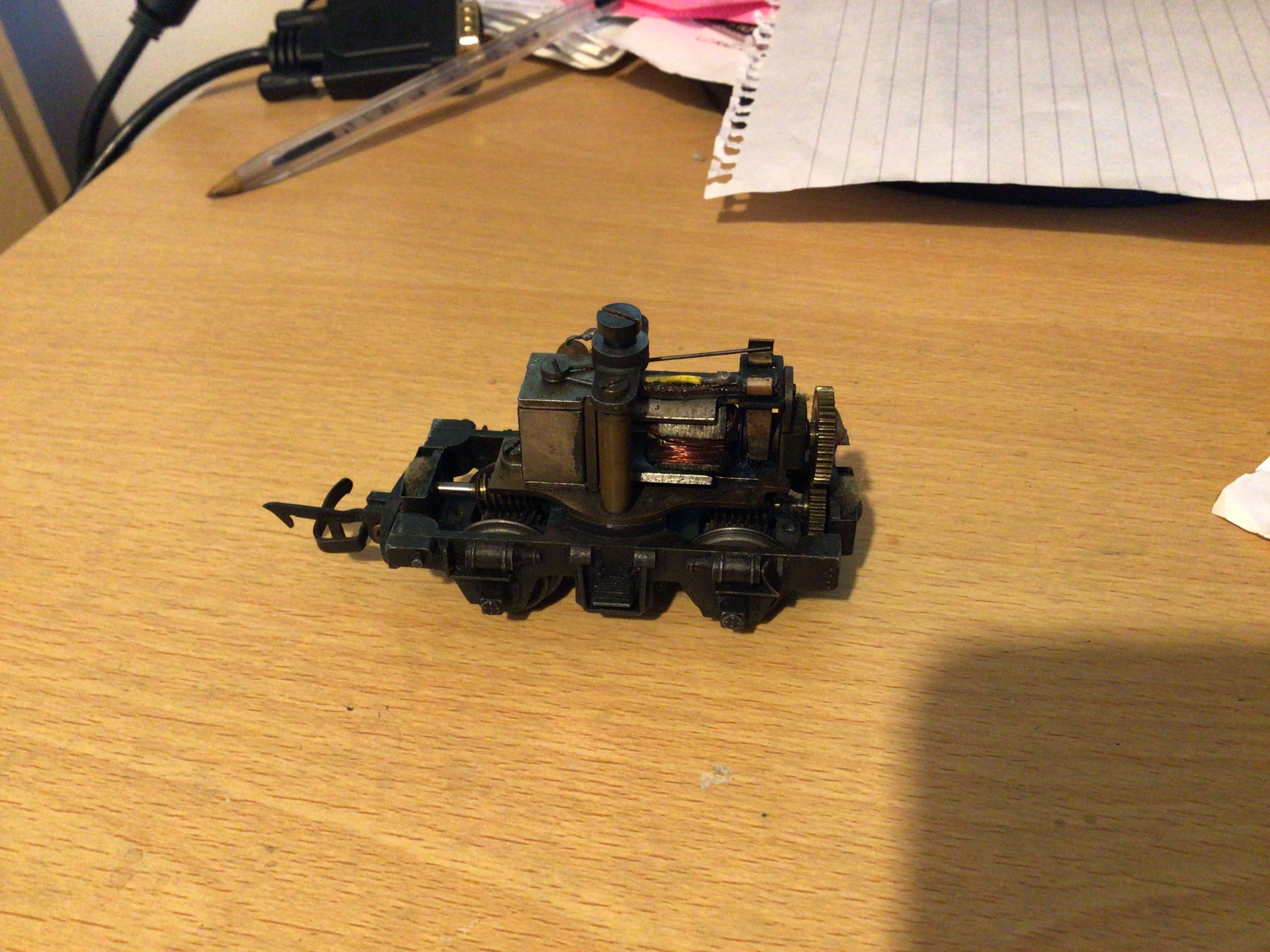

My latest fun thing. Now I can restore one of my old Transcontinental locos properly. I have the cow catcher but do I replace the wheels?????

That knurled wheel sound was pretty distinctive if I remember well!!
I had a Pullman and a Class 81 - both with them.
They did assist with traction, unless you increase the locomotive weight and replace with smooth 'normal' wheels.

That's an oldie, RT. Your railway, your rules but given the bogie's age might it be a shame to replace the wheels with something non-original and lose the familiar Triang growl?

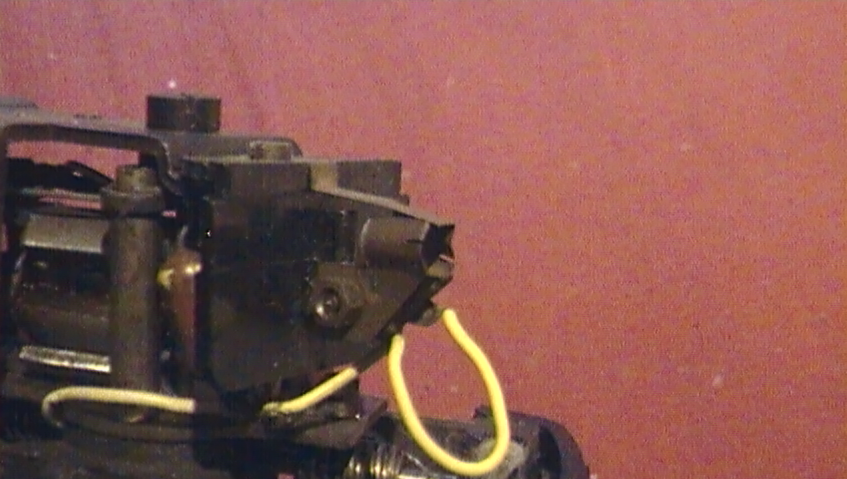

That’s what I was pondering Threelink! I have a spare set out of a later dock shunter but that would lose some of the mojo. I have now put it into a chassis ready to go into what I thought was an origami all MK1 version of the A unit but the light holder must have been a different design. The screw catches on the top of the X04 motor and the bottom of the holder is in the way of the screw that holds in the brass mounting for the motor. Looks like no lights. tired_face
I have a cow catcher for it so will fit that as soon as I find it.

Hi Rana
That is a MK2 lamp holder used on later versions the MK1 has a brass bulb holder,
Have a look at Service Sheet 6 (Lendons have it.)

Thanks Tony57, I think I have one of those brass bulb holders in a box of ‘junk’ I got a few years ago, that makes perfect sense. I always thought this chassis was from a MK1 version of the loco but obviously not. You learn something every day!
