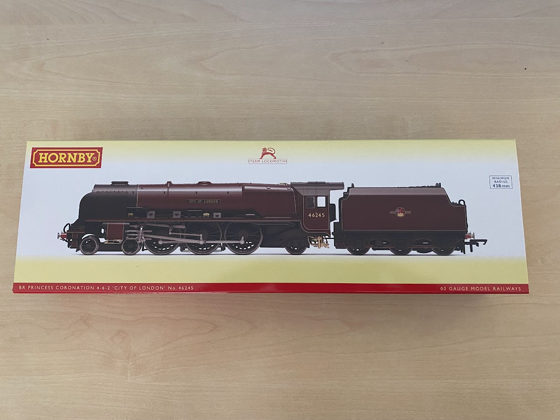

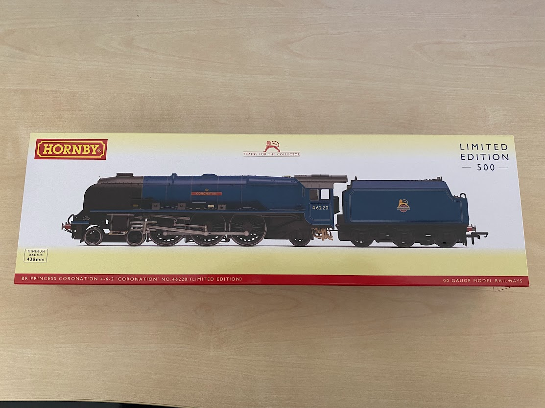

Great minds DRC, I must have got a cancelled order for the Coronation, following a tip off on the forum, and decided to replace my 63 year old Hornby Dublo City of London at the same time

Nice pair DRC!! My Coronation was due to be delivered today, but I was going to be out so put DPD delivery off until Tuesday.
