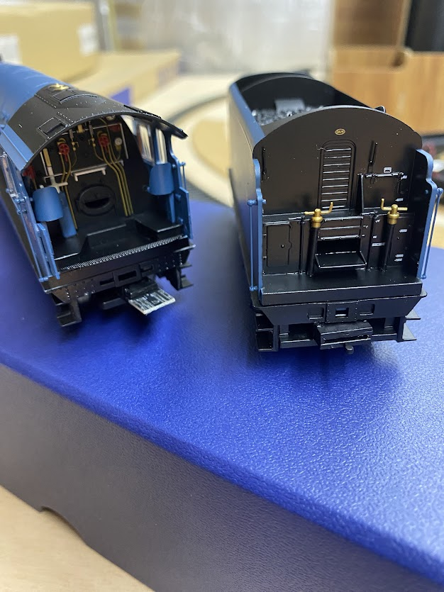

Although this is a clever and in my opinion, better looking design than the simple bar connector, it does seem that the loco and tender are separated very easily. It doesn't take much effort to pull them apart at all, and I'm foreseeing separations when hauling long rakes of coaches. Although this will be a pain, the loco itself will simply come to a stop without the tender attached. I'll try it this weekend and see what it's like.
