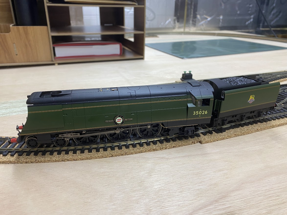

Posted at 18:37:20 Fri 10 Mar 2023
Very nice Deem, I have one of those myself. It may just be mine, but it has a bit of a dodgy front bogie, seems to like to work itself loose. Might be worth having a look before letting it loose on the track.
Thanks for everyone's comment. I did find it having issue's with front wheel bogie been wondering especially when going over points (Hornby R8072 - R8073) for first few attempt, I looked and found the packaging between the chassis and bogie, as I removed it, Loco seem to been running fine, but only used for few minutes and stored it away. I want to keep as it is, until I have received the HM700 Bluetooth decoder and will try that again with sound.
Posted 18:37:20 Fri 10 Mar 2023
Posted at 19:07:52 Fri 10 Mar 2023
If the front bogie is derailing, a couple of things:
  1. Have you checked the B2B - back to back dimension. Typically 14.3-14.5mm. If too small, wheels can lock against the bogie frame and/or fall off the track.
  2. How is the track itself - 16.5mm between rails - the track itself may be slightly deformed?
  3. When you slowly lift the locomotive up, does the bogie start lifting off right away, or is there 'a little slop' permitting the bogie to remain a little? If lifting straight away, there's not enough 'weight' on the bogie.
Posted 19:07:52 Fri 10 Mar 2023
Posted at 22:49:19 Fri 10 Mar 2023
Thanks Al,
Loco ran fine after I remove the packaging from front bogie, so at the moment I will leave the loco in storage, until i have 8 pin TSX decoder, I will try again at that time.
Regards
Posted 22:49:19 Fri 10 Mar 2023

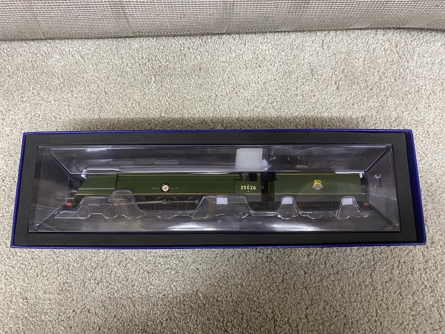

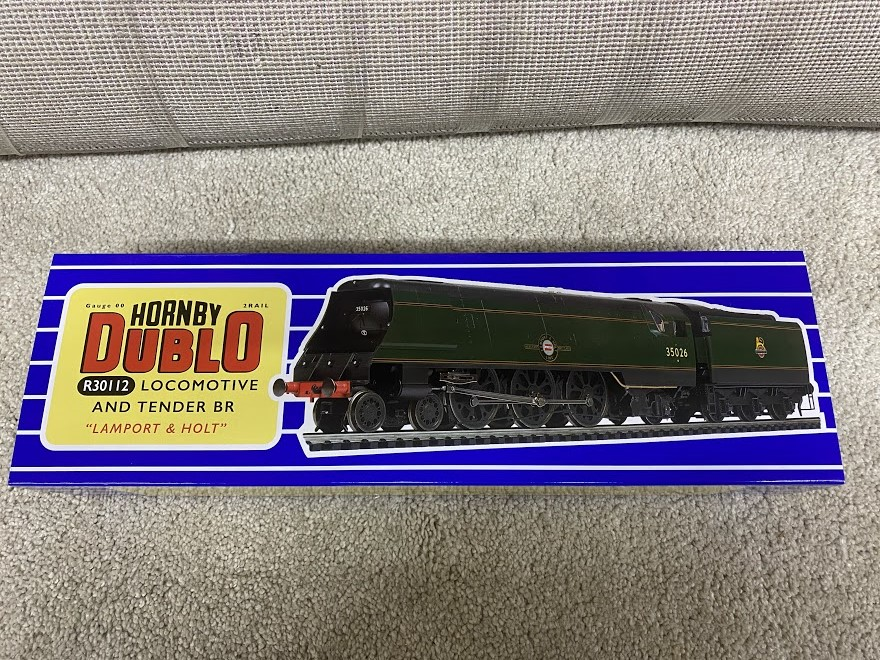

Posted at 14:27:15 Sat 11 Mar 2023
Been after one of these for a long time, finally managed to find one and bought it as soon as it was listed.
This was scheduled for delivery on Monday, but a nice Saturday surprise. I'm blown away by this thing, it's absolutely stunning.
Posted 14:27:15 Sat 11 Mar 2023
Posted at 18:08:41 Sat 11 Mar 2023
@DRC
I have not unpacked mine yet - it also arrived this morning (via DPD!!). It looks a great loco. You made a good choice smile. It should look good sitting next to 35011 General Steam Navigation - one of last years Hornby Dublo models.
Posted 18:08:41 Sat 11 Mar 2023
