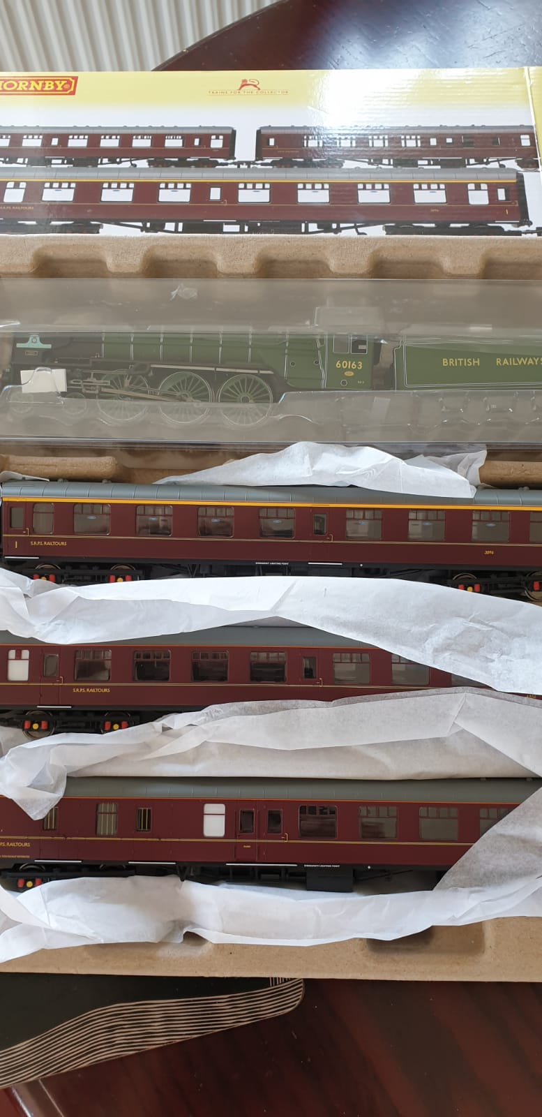

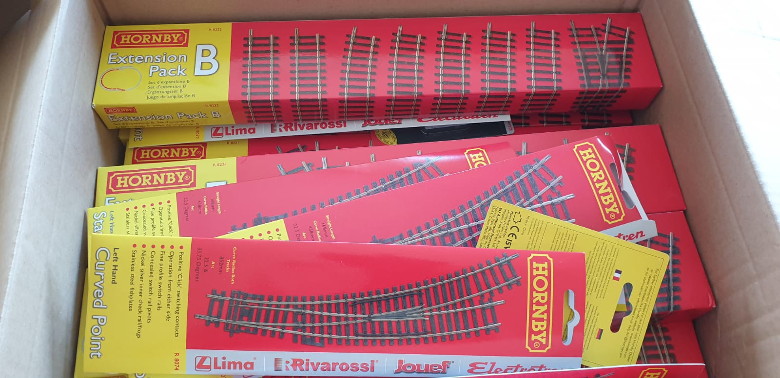

My latest (and first) acquisitions! A box of extension packs (A-F), 7 points and 2 decoders and the 'Aberdonian' train pack (R60163), all from Amazon. I also have orders placed with Hattons (a Rushton Diesel and some wagons) and with Hornby (mostly track and the Select DCC decoder.
When they all arrive, I'll take stock (including rolling stock - pun intended) and then see what else I need, or forgot to order.
I have already ordered track clips for the points and a 14 amp transformer for the Select controller.

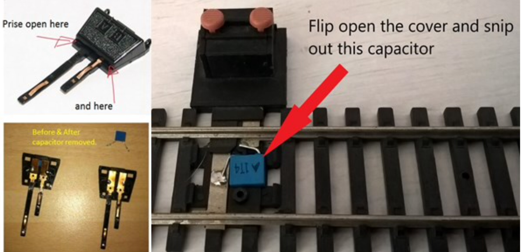

I realised, too late, that I'd got the wrong power track (no mention of a DCC one in the track plans book).

No problem with the power track, just convert it to DCC by snipping out the capacitor. Oddly the one with more parts is cheaper.
Check the points as there was a bad batch that were shorting internally.

Thanks Rob. I actually watched a YouTube video on that last night. Will give it a go.
